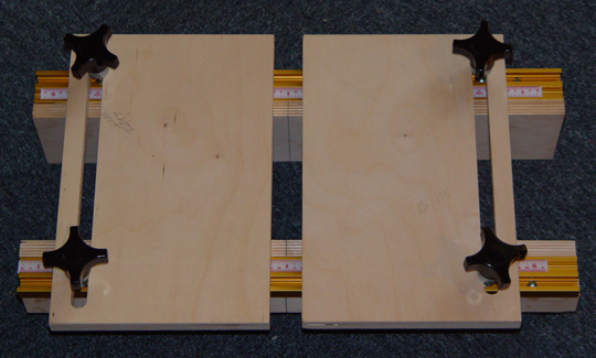

I was looking around on the net the other day (can't remember where, maybe MIMF?) and saw some ideas for endgraft jigs being kicked around.
Not being one to re-invent the wheel, I have whipped up my own version of one of the jigs, and thought I would put up a couple of pics in case anyone is interested.
It's made from some scrap Baltic birch ply, and a couple of 18" lengths of IncraTrac I got from Woodcraft. I'm hoping that having the rules in the jig will help avoid any mistakes.
Note the "high tech" spacers under the knobs...(stacks of washers super glued together!)
I still need to add some cork or felt for padding on the clamping surfaces, and I might get really fancy and cover the router bearing surfaces in some 1/32" phenolic...still thinking about that part...

Looks good, Russ. Do you have the ability with your jig to cut a tapered groove?
And do you use this with bushing guides on your router?
PostPosted: Tue Oct 11, 2005 6:18 am
Looks like he can accomodate all that Steve. Very nice jig Russ! Now provided you have the top and back lined up on center, it should be easy to get good results!

It looks like this is the kind of jig that uses a top bearing flush cutting bit. You cut the graft, place it on end of guitar, and slide sides of the jig up against the graft and tighten it down. Remove the graft and route the slot.

As Don says, the jig is fully adjustable for cutting tapered end grafts. The jig is built to use (as Mike stated) a pattern router bit that rides on the edges of the top pieces, but could also be use with busing guides.
The top pieces can slide back and forth in the IncraTrac to make various sizes of wedge. I am also making some curved pieces, so I can cut endgrafts with curved sides also.

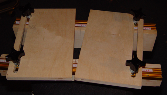

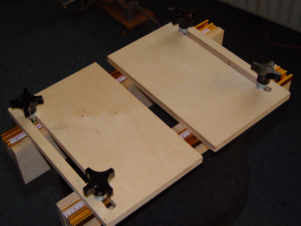

Here is a pic with the guides set up for a wedge cut:
Russ

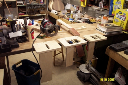

I just built and end graft/neck joint jig and some other neck jigs, but not as elaborate as your's. I just borrowed (ok ripped off) some that were on the John Mayes DVD set, which I can't say enough about. The DVD's are great for the beginner. Here they are:
The left is for the neck joint in the body. The right is to make the male end of the joint on the neck heel. And the middle is to cut the cheeks for the neck.
This shot shows the backing below the jigs where I clamp what I'm going to routeBlueSpirit38637.1021759259
